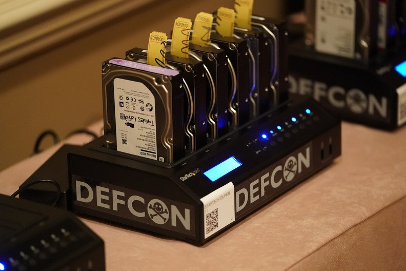

    Click image for larger version  Name:	DDV-Duper.jpg Views:	158 Size:	105.4 KB ID:	236584
    Click image for larger version  Name:	DDV-Drives.JPG Views:	161 Size:	2.01 MB ID:	236585
