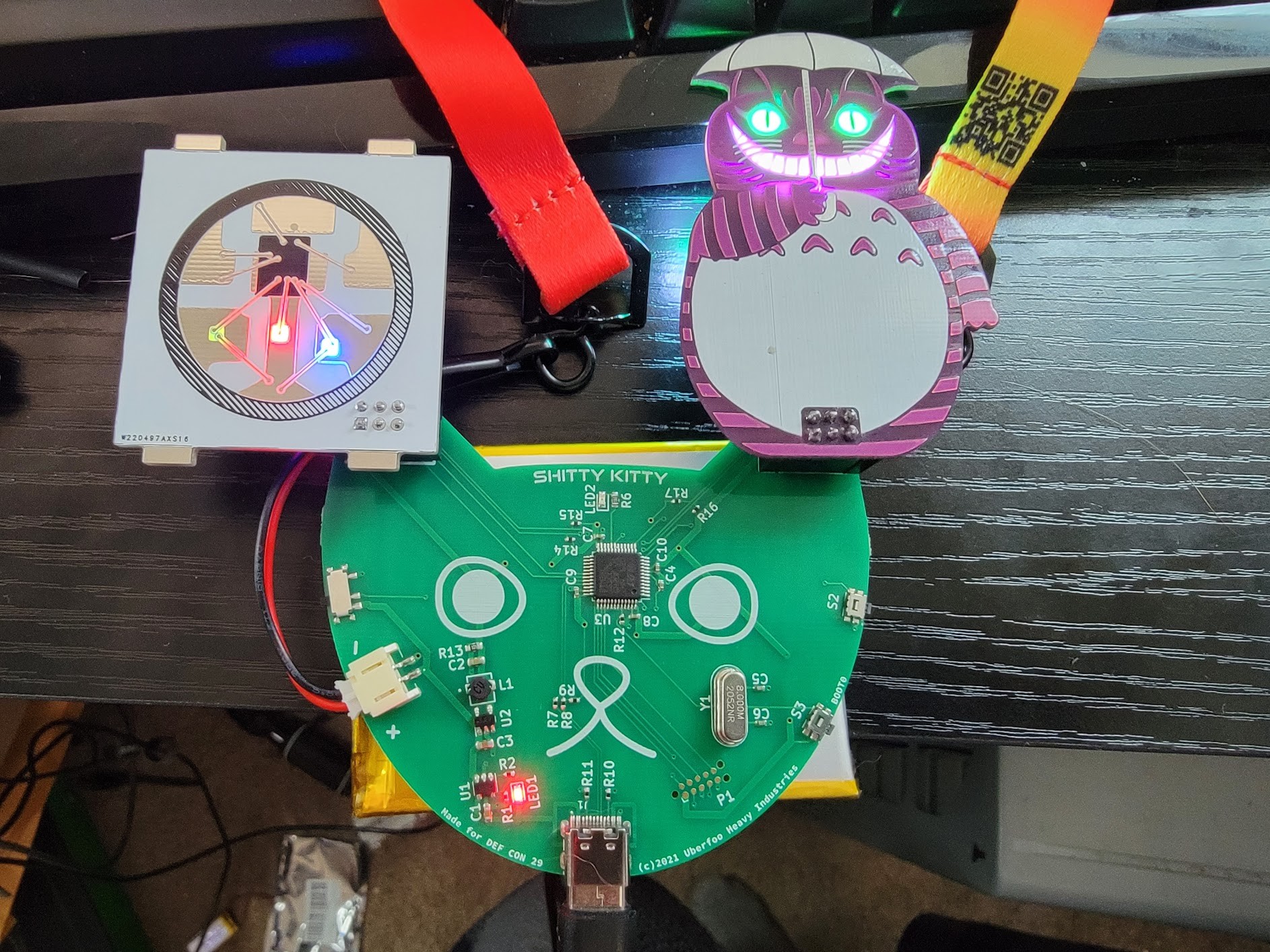

                  Good news, and bad news. The shipment has arrived!!
                  But... the badges mostly seem to work, except we cannot seem to get USB to connect to the uC. This means you will not be able to program or operate the badge using the USB connection. The badge can still be programmed, but it requires a special $60 cable and an STLINK-V3SET.
                  I haven't soldered on the SAO ports yet, but I'm fairly confident that at least those will work.
                  So the big question. Now that we know it is missing some of it's most compelling features, is anybody still interested in buying one. They cost me at least $50+ a unit to make, I'd hate to sell them at a loss even if profit was never my motive.
                  Thoughts anybody?
                  Sincerely,
                  A Sad Uberfoo

                    #15
                    Turns out if you use things as designed, they tend to work better. All we had to do was attach a battery and now everything is working correctly. So lesson learned. Shitty Kitty will not work without a battery attached. Good think I stocked up on them.
                    Here's a picture of one in action (pictured with a Silly Pixel and Chestoro).
