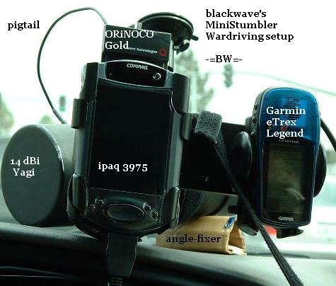

          here is my iPAQ setup :)
            Very vool BW, how much did they set-up cost you?
              What you see in the picture was bought all new. No coupons or deals or stacked online rebates... I just pretty much walked into a couple of stores and picked it all up, except the yagi and the card... let's see...
              iPAQ, PCMCIA sleeve, car adapter around 1200 out the door with tax
              ORiNOCO Gold around 80
              GPS, cables, mounts, adapters around 350
              Yagi around 70
              so that is around 1700, but more around 2000 ... it isn't cheap that is for sure.

                Ok cool, I got a b-day coming up so I know what Ill be asking for, for my b-day hehe.
