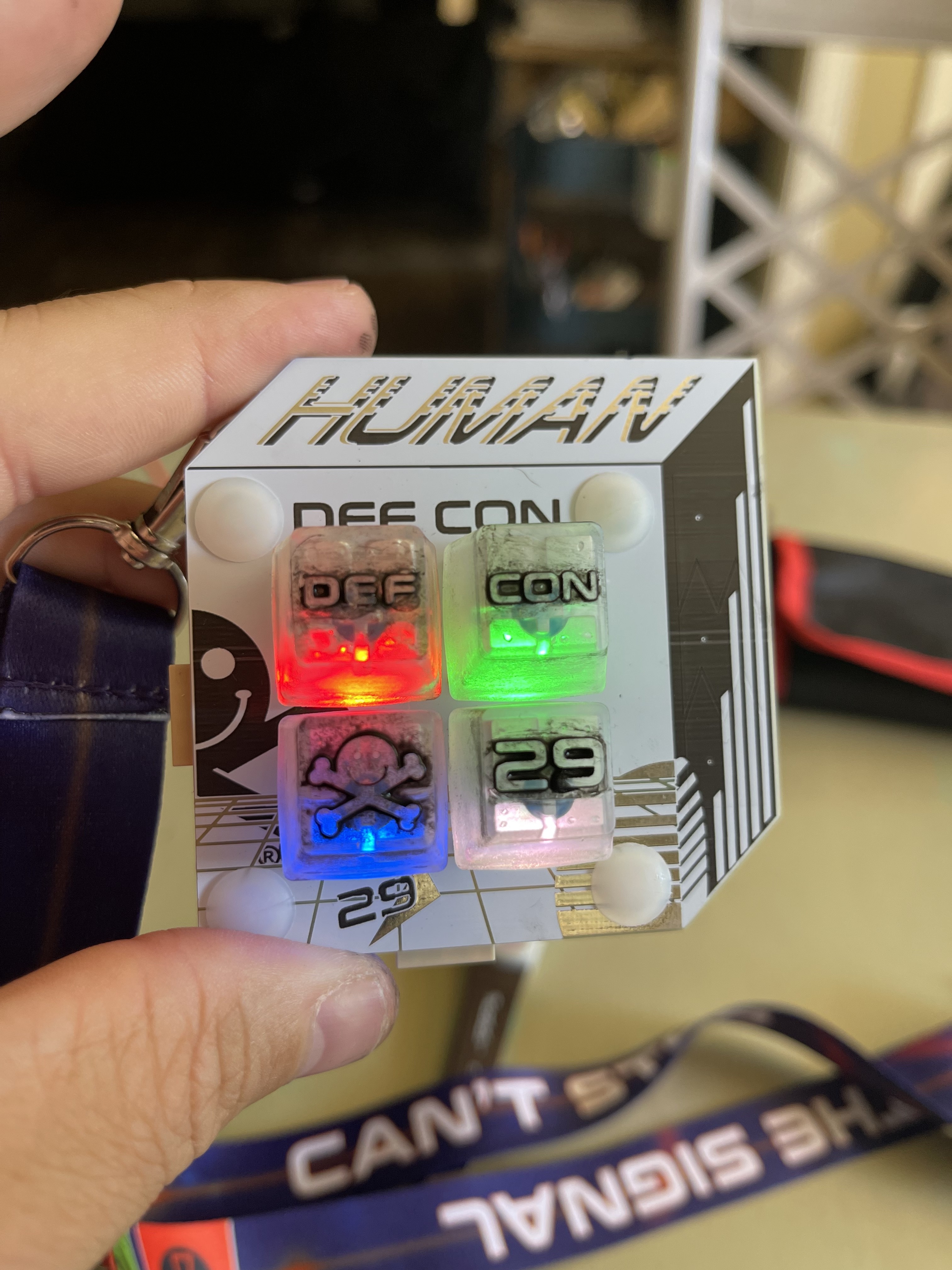

            #27
            Custom defcon 29 keycaps
            • wyatt_earp
              wyatt_earp commented
              Those are sexy!!!

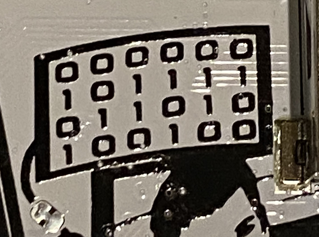

              #30
              On the back of my badge the binary converts to ASCII 'Red' when read top to bottom, left to right.
              01010010 01100101 01100100
              **Credit to my 14yo daughter for finding this. DEF CON has always been a family activity.
