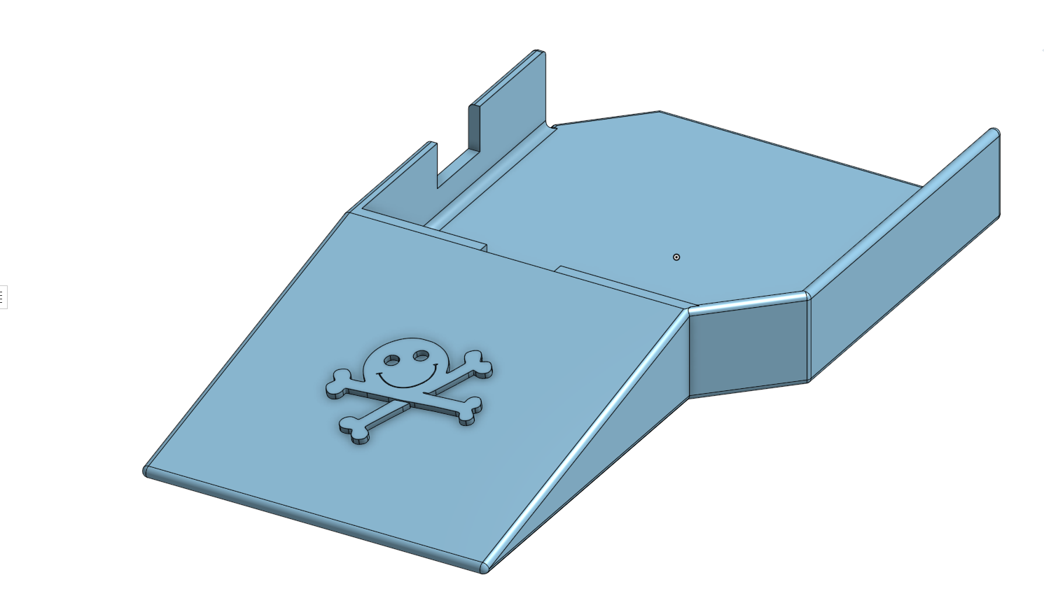

          In the event you want to have a case for you badge so that it doesn't slide around your desk, I whipped this up
          https://cad.onshape.com/documents/95...f173e047bd5c06
          Printed on an Ender5
          • 0.2mm layer hight
          • 10-20% infill
          • 50-80mm/s speed
          Here's a draft version of the holder - https://imgur.com/gallery/sb8Ba0F
          • StackingAces
            StackingAces commented
            I don't have a 3D Printer can I buy this somewhere?
          • Zaph
            Zaph commented
            Thank you for sharing! Just printed mine.

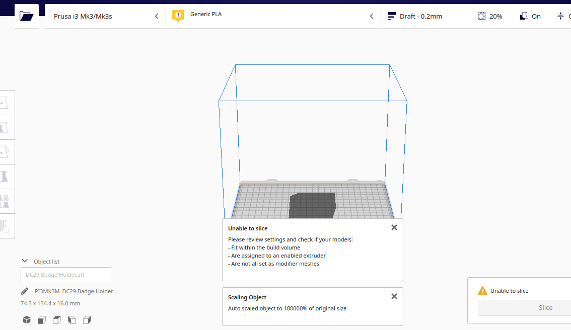

          I tried downloading a .stl file for this, but for some reason the dimensions are really wonky. I've tried both PrusaSlicer and Cura. PS will slice it if I blow it way up, but Cura just refuses and generates errors.
          Can you please tell me what the max dimension on the X axis is? From your drawing it looks like about 73mm (~2.87") but I can't be sure, and I don't want to print it until I know the size. I want to print this and bring it along with me.
          Thanks.

            I noticed that OnShape is defaulting to exporting in meters instead of mm ... I don't know why because the project is set to mm. It should be pretty close to 72-73mm. Let me see if I can fix the link for editing.
            I exported the STL and put it on Thingiverse to try and address the slicing issues. Cura 4.8.0 didn't have any issues with it?
            https://www.thingiverse.com/thing:4919582

              I have Cura 4.8.0 and here's what I get when I try to slice it ...

                The one on Thingiverse slices normally. It says the X dimension is 74.25mm. I'll try printing it when I get back home.
                Thanks.

                  Thanks for letting me know - I'm not super familiar with the OnShape thing - but clearly the Thingiverse distribution is a better idea!

                    I just got in. It sliced fine (PrusaSlicer) and is now printing. Gonna take 2 hours and some minutes to print. I'll post a photo when it finishes.

                      Here's the finished print ...
                      Looks good and printed nicely. Thanks.
