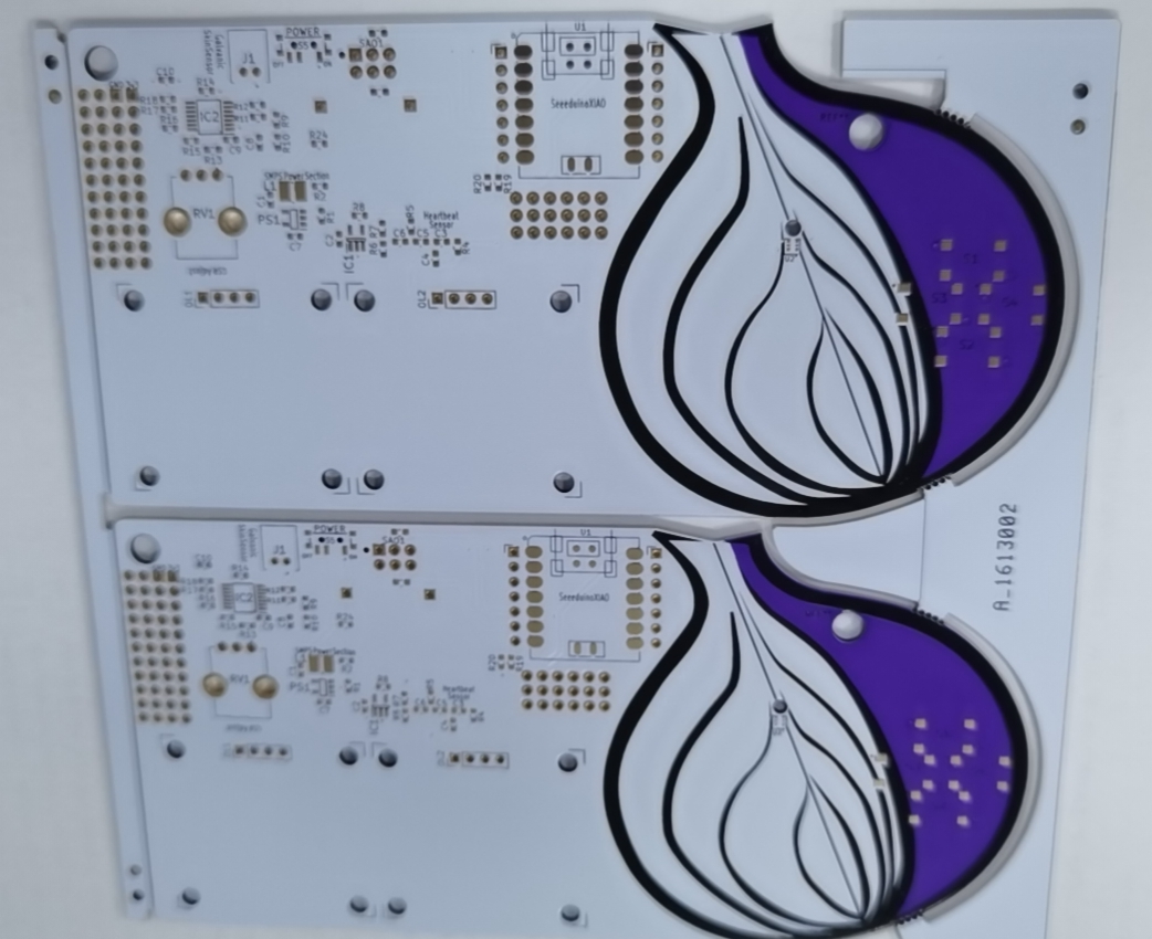

    We are attempting to pull off a Tor badge this year for Defcon 29. All profits will go to the Tor organization (just like 2 years ago).
    Although they will not have a vendor booth this year, so I'm still working on some logistics.
    I should have the badges by mid July and assuming they work I'll be able to provide more details then.
    For now here's a blurry picture teaser from the fab

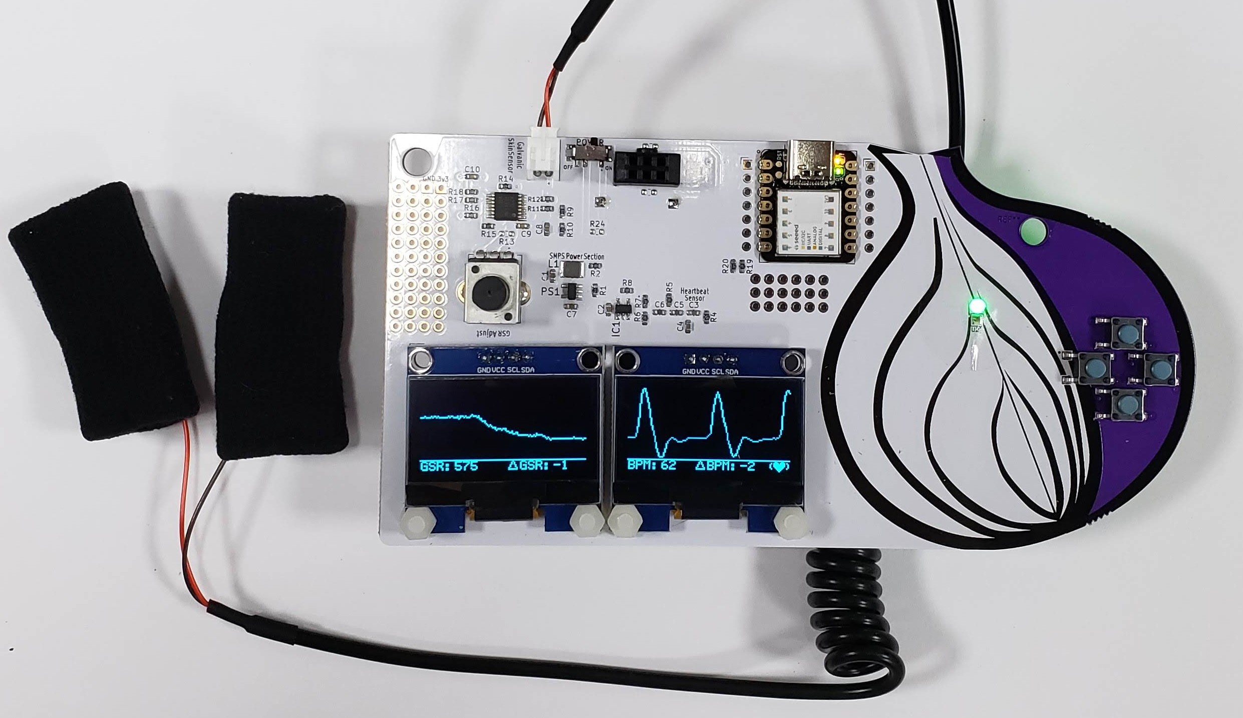

    I received the working boards so it looks like this is happening, here are the details:
    What it does - It acts as a mini lie detector. The badge has two primary sensors, a GSR sensor and a heart rate sensor. These are two of the sensors used in a polygraph machine. The output of these sensors with some statistics is graphed to each of the two 1.3" OLED screens.
    Use it to interrogate your friends, or to practice how to get through your next fed-job interview
    Hardware - It is run off a cortex M0+ arduino based xiao, that you can connect to via USB-C. The stock firmware also outputs the raw data over serial USB to allow further analysis of the data on a computer. There is one 1.69bis SAO header, finger cuffs used for the GSR sensor, and is run off two AA batts with a boost vreg to 3.3v.
    There are 0.1" headers for every pin on the xiao. There is also 3.3v/gnd and other 0.1" holes available for prototyping.

    Here's a higher-res picture with the current state of the interface (there are some other modes besides this primary lie detector mode).

      What do they do?
        Basically a lie detector. This badge has two primary sensors, a reflection-based pulse sensor, and a galvanic skin response (GSR) sensor. These sensors are traditionally used in a polygraph machine, and GSR is also used in the E-meter.
        It has two 1.3" oled screens for sensor output and analysis. It runs on a xiao that has a USB-C connector and is easy to reprogram with arduino
        You can practice your interrogation skills on a friend, or practice beating a polygraph for your next fed job.

              The image is blurry - is that an ESP8266 in the corner?
