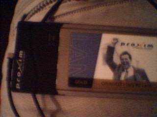

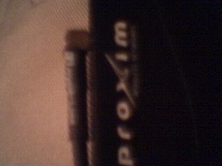

              ok first of all, i OWN the proxim orinoco b/g gold card. IT STILL HAS THE ANTENNA JACK. here is the problem with this great card. They changed the connector port to another proprietary type. They sell the new one from hyperlinktech.com
              I found this out the hard way after i baught my card ($84) and then a pigtail for orinoco. well it arrived, and it seemed a little tough to pop on, but it did. now i cannot ever pull it off or i will rip out the internals to the card and the antenna connector. i called proxim to bitch, they could do nother nor does the 3 year warrenty cover this. they did send instructions for how to disassemble the card and remove the antenna conecter manually thus voiding all warrenties implied with the card period. so i sadi fuck you, ill just leave it plugged in permanently.
              im using it in conjuction with a 5dB gain omni-directional antenna that magmounts to the car. this thing has EXCELLENT range, and im looking into buying a bi=directional 800mW amp for it. increasing over all gains to around TX=17dB and RX=15dB
              but yea,. the proxim has the connecter

                got pics of your circumstance?

                  #23
                  right here.

                    #24
                    better pics.
                    http://www.lanschoolyard.com/1.jpg
                    http://www.lanschoolyard.com/2.jpg
                    It also uses the Atheros chipset, so that means currently for Netstum .30 you have to use the NDIS.
